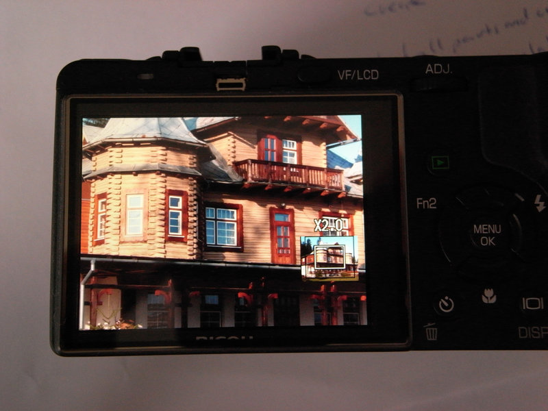

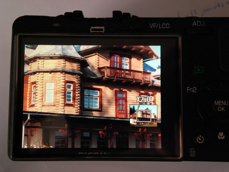

There are also some screen artifacts. Below pictures displays GX200 LCD, but it's the same on GRDII LCD.
Steps to reproduce:
- Make sure the AutoRotate option is set ON.
- Take one vertically and one horizontally oriented photo.
- Switch to "preview" mode.
- Zoom up the actually previewed photo a bit (let's say 4 times)
- Try move the zoomed preview (using the arrow keys) - it works as expected small (right/left=horizontal move, up/down=vertical move).
- Switch from vertically to horizontally (or vice versa) oriented photo (using the rocker wheel) >> The zoom factor should be preserved.
- Now try move the preview using the arrow keys - the preview moves in wrong direction! Instead to Left-Right it goes Up-Down and vice versa! The small preview rectangle works fine. It's just the main preview, which goes in wrong direction.
